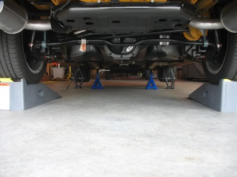

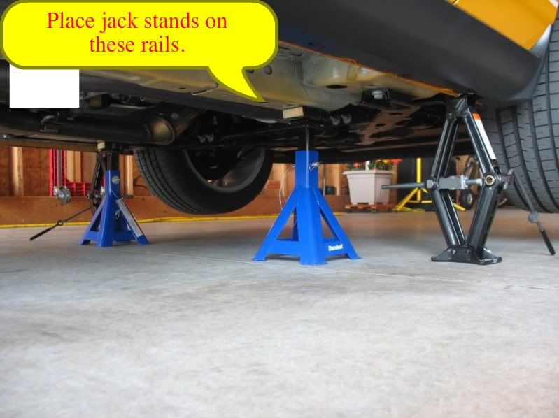

1. Raise the car on either side with Jack drive on ramps or have car on lift. Place jack stand under car for safety.
Some pics provided by a team Shelby member, Grabber, used with his permission. http://www.teamshelby.com/forums/index.php?/topic/29264-the-ford-factory-jack-and-where-to-place-it/
DIY Oil change Jackposition4
DIY Oil change DSC06632
DIY Oil change Jackposition3

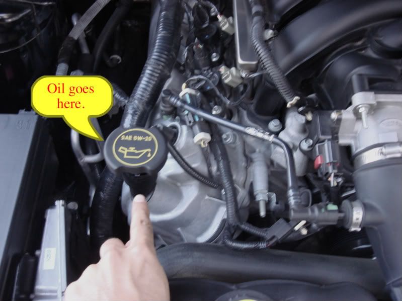

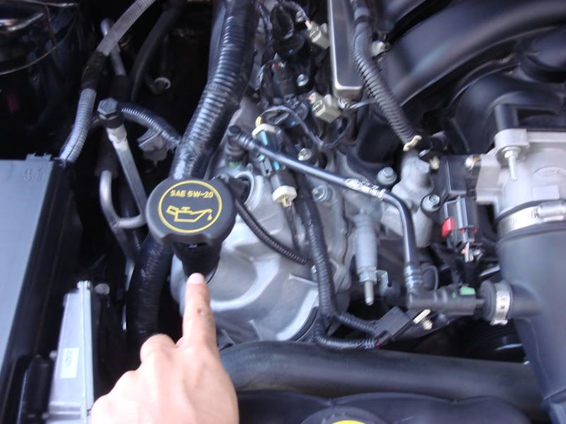

2.Open hood, open the oil cap cover slightly to let it vent when oil pan bolt is off to increase flow of drainage.
DIY Oil change DSC06697

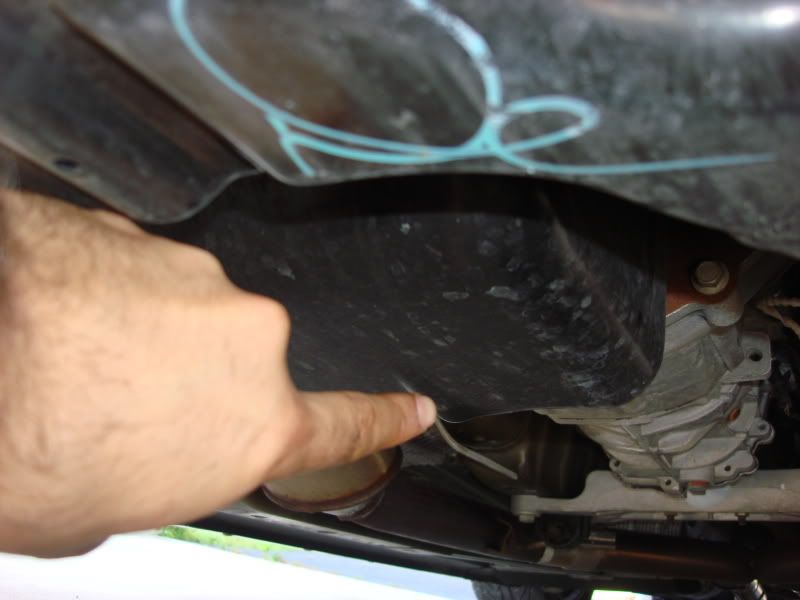

3.Crawl under the car and locate the oil pan. Bring along your tools to loosen up the oil pan bolt, bring your oil catcher, gloves,rag.

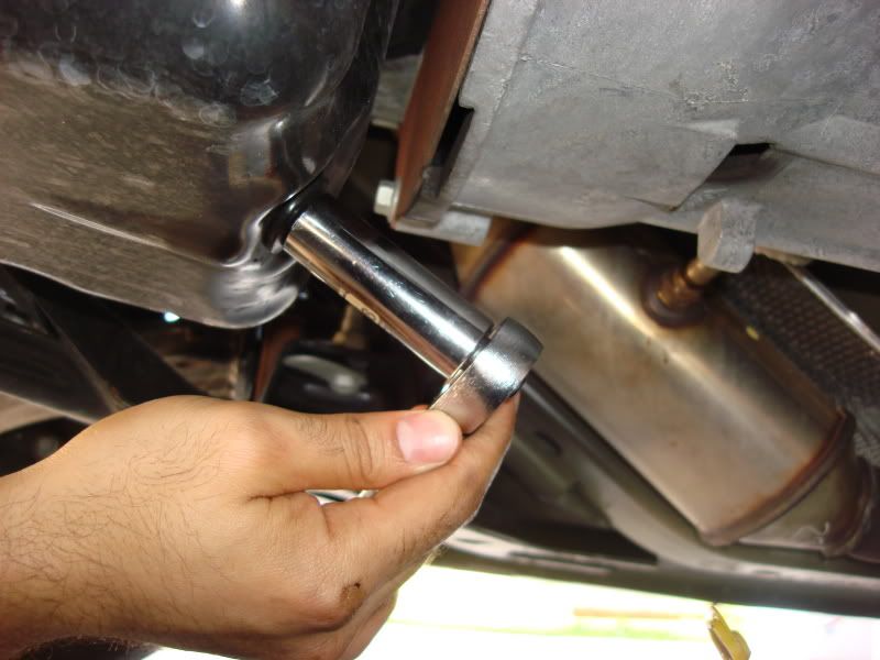

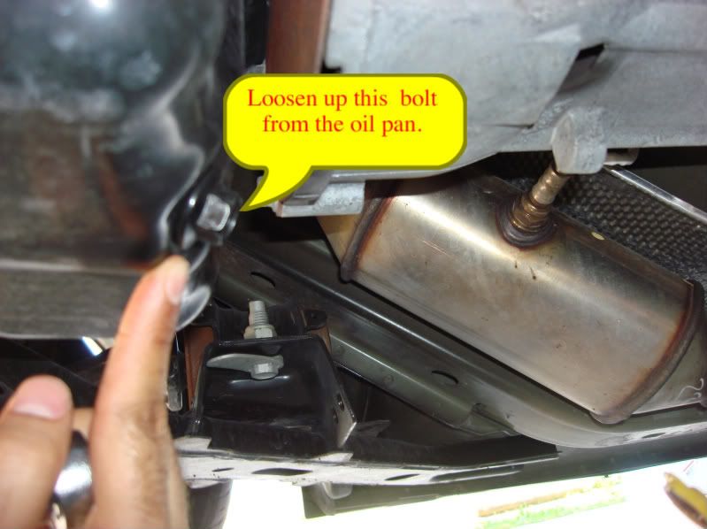

4.Loosen up the oil pan bolt. Place oil bin/catcher under the pan to catch the oil.
DIY Oil change DSC06593

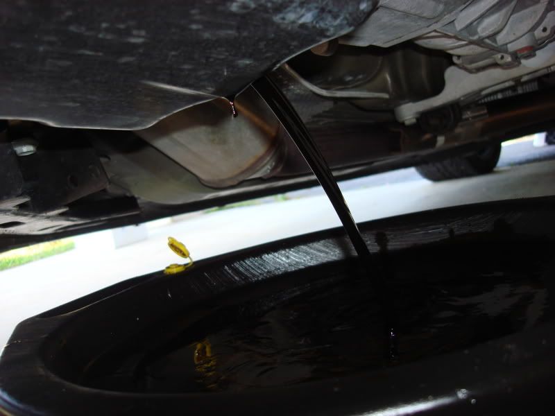

5.Let the oil drain.
DIY Oil change DSC06594
6.Once the oil is drained, place the bolt back. Please do not overthread the bolt, you may strip the threading.
DIY Oil change DSC06595

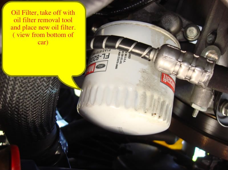

7.Locate the oil filter- it is towards the front of car near front bumper.
DIY Oil change IMG_0073
8. Take the oil filter off with the special oil filter tool( toll can be purchased at any tool shop) and let it drain again.
DIY Oil change DSC06597
9. Put new oil filter on (leave it empty), note to place a small amount of oil on the rubber gasket of new oil filter and hand tightened the new filter, do not over tightened the oil filter.
10.Put six quarts of oil in the engine (six quarts is for the V-8, V-6 check manual for required amount.)
DIY Oil change DSC06697-1
